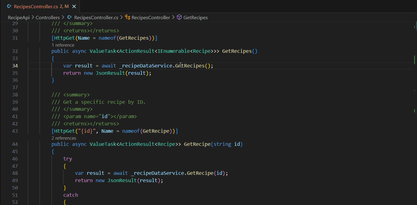

Peek Definition
You can take a quick look at how a symbol was defined by using the Peek Definition feature. This feature displays a few lines of code near the definition inside a peek window, so you can take a look without navigating away from your current location.
To peek at a symbol's definition, place your cursor on the symbol anywhere it's used in your source code and then press ⌥F12 (Windows Alt+F12, Linux Ctrl+Shift+F10). Alternatively, you can choose Peek Definition from the context menu (right-click, then choose Peek > Peek Definition).
Peek Definition example

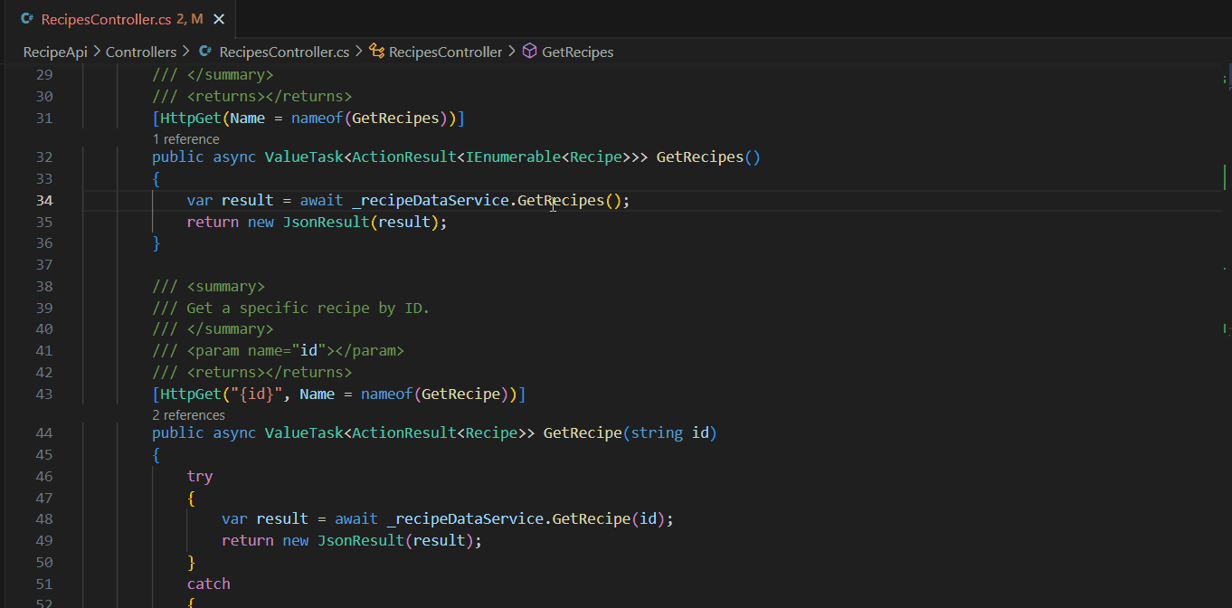

Peek References
You can get an inline list of sources where a selected symbol has been referenced in your code using the Peek References feature. Place the cursor on the symbol anywhere it's used in your source code, right-click, then choose Peek > Peek References.
Peek References example

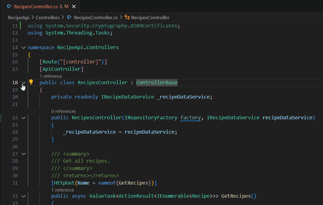

Collapse or expand code snippets
To better view the source code, hover over the editor gutter to collapse or expand code snippets using the caret that appears.
Collapse or expand code snippet example

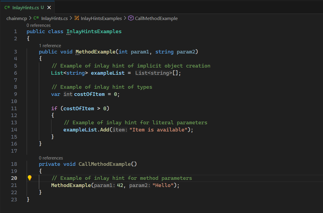

Inlay hints
Inlay hints are subtle annotations that appear inline in your code to provide additional context about your code elements. In C#, these hints can show parameter names at call sites, type information for variables, and other helpful details that make your code more readable without having to navigate to the definition. These hints can be particularly helpful when working with methods that have multiple parameters or when type inference makes it less obvious what type a variable is.
Inlay hints examples
To change which inlay hints you want to enable or disable, view the csharp.inlayHints settings.
